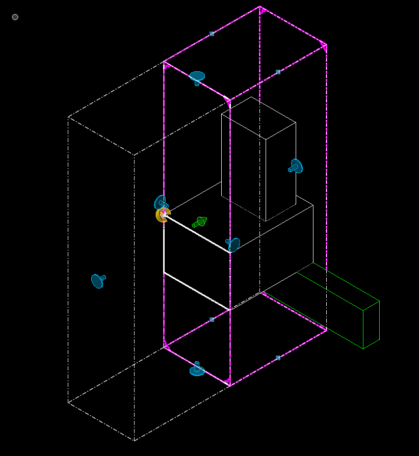

  1. Clicking on the white rectangular section clip (image 1 below) should show the Clip Volume Edit Handles, in this case nothing is displayed

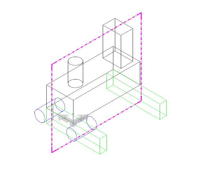

  2. Check if the Disable Handles option in the Element Selection tool is enable (image 2)
  3. If it is, disable it and ensure the Element Selection tool Method is set to Individual and the Mode set to New

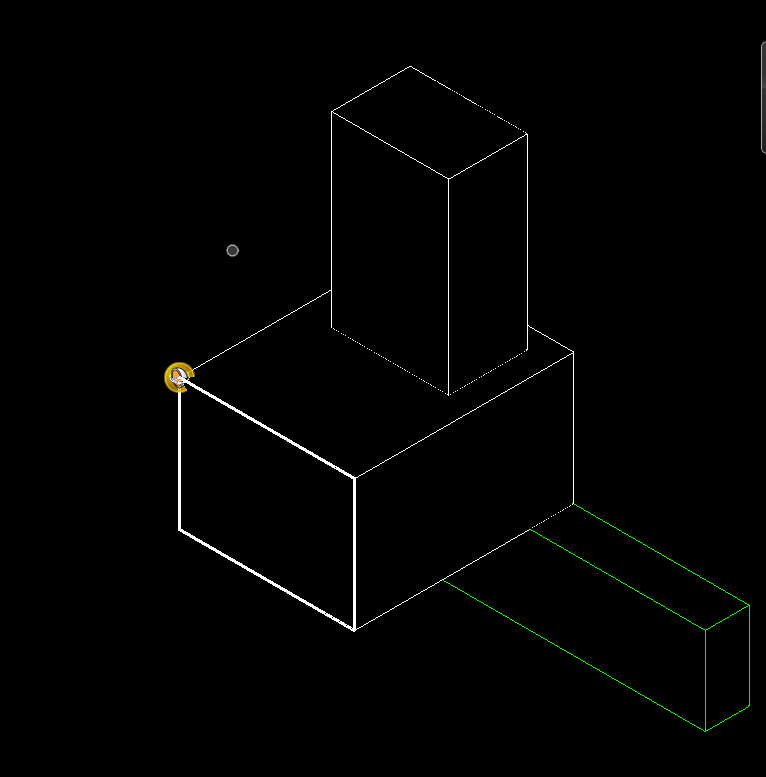

  4. Click on the white rectangular section clip box and the blue and green Clip Volume Edit Handles should show (image 3)
Image 1 - no Clip Volume Edit Handles
Image 2 - Disable Handles, Element Selection Tool
Image 3 - Clip Volume Edit Handles displayed

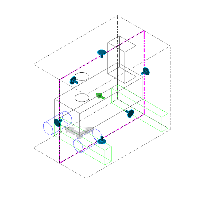

Note: If there is no white rectangle section clip box displayed either (Iamge 4), and the Disable Handles option is switched off left click on the Marker icon in the view to show the Edit Clip Volume Handles as shown in Image 5 below
Image 4 - No white rectangle section clip box shown
