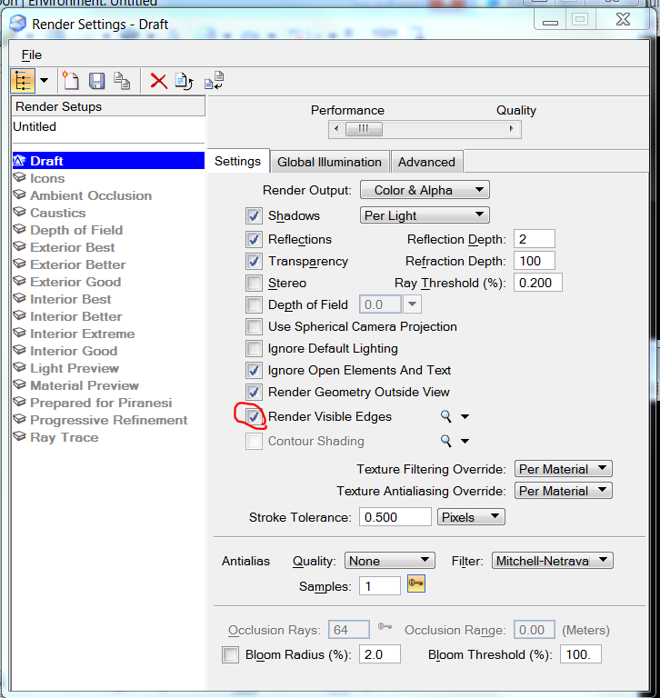

How to display the edges/contours of the solids when rendering using Luxology
1. Go to render settings
2. Select a Render Setup or create a new Setup
3. In the tab: Settings, tick the option: Render Visible Edges
4. Save the selected Setup
5. Open the Luxology Render Manager window
6. Go to the option: Overlay Visible Edges (lower right corner)
7. Tick the option: Hidden Edges
8. Click to activate the button: Overlay Visible Edges.
How does it work:
Luxology produces a render output with visible edges as well as a render without visible edges.
Overlay Visible Edges allows you to toggle between these outputs.
