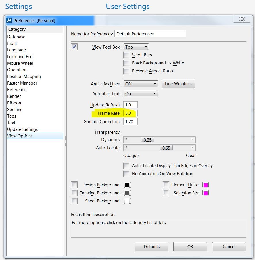

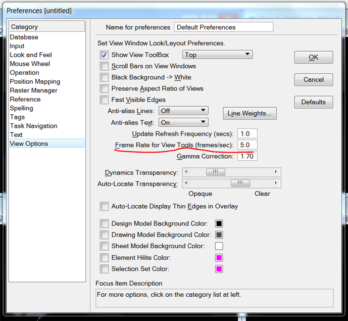

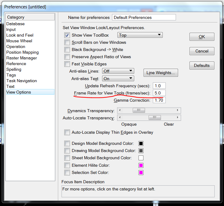

When rotating the rendered view of a large, complex 3D model display may flicker and some elements may temporarily disappear.
Decrease Frame Rate for View Tools
Decreasing "Frame Rate for View Tools" in Workspace > Preferences, View Options may give enough improvement.
This value (default 5) is the number of full or key frames calculated during view manipulations, not the number of frames displayed.
(images from V8i and CE)
