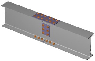

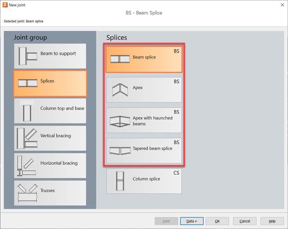

Beam Splice Connections
Beam Splice Joints
In RAM Connection, Beam Splice (BS) Joints can be created with the following configurations:

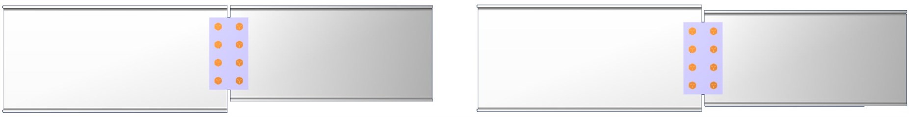

In addition to the connection specific options listed in the table above, the following member configuration can be customized for beam-splice connections for shear reactions can be customized in the connection pad:

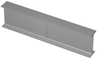

  • AISC: Fully DW (FWBS)
  • I-Shaped
  • Tapered I-Shaped
  • Haunched I-Shaped
  • Beam Size: Beams must be the same depth.
  • Vertical Angle: Max 30º

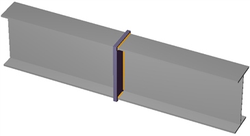

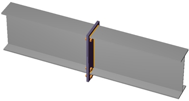

  • AISC: Moment End Plate (MEP)
  • AS: Bolted End Plate (BEPBS)
  • BS: Bolted End Plate (BEPBS)
  • CSA: Bolted End Plate (BEPBS)
  • EN: Bolted End Plate (BEPBS)
  • IS: Bolted End Plate (MEPBS)
  • NZS: Bolted End Plate (BEPBS)
  • I-Shaped
  • Tapered I-Shaped
  • Haunched I-Shaped
  • Beam Stiffeners: Available in the Connection Pad.

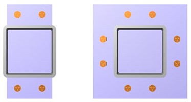

  • AISC: End Plate HSS Moment (EP)
  • AS: End Plate HSS Moment (EP)
  • CSA: End Plate HSS Moment (EP)
  • EN: End Plate HSS Moment (EP)
  • Rectangular
  • Beam Shape: Beams must be the same shape.
  • Bolt Configuration: 4 Bolts (default) or 8 Bolts
