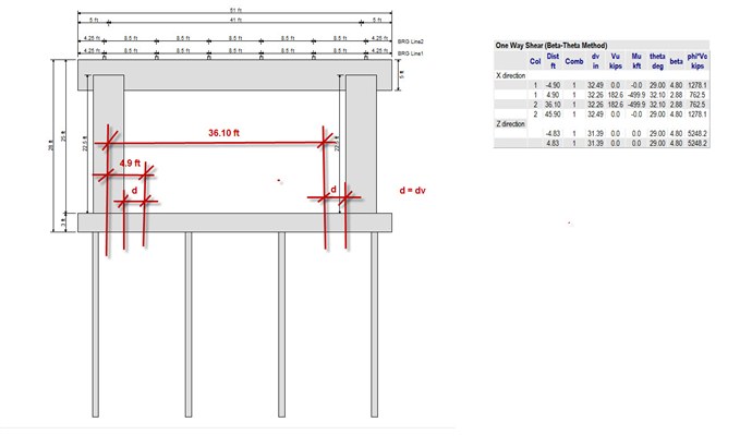

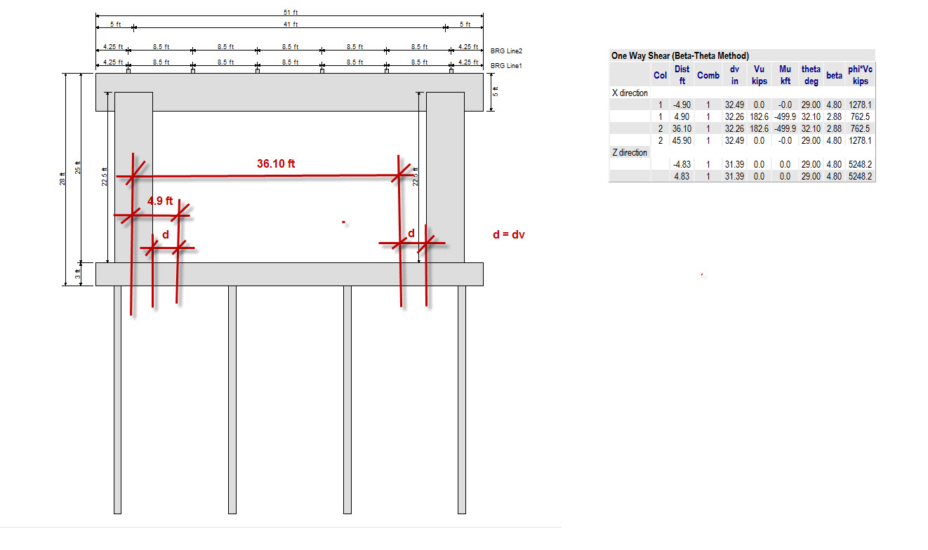

QUESTION: One way shear :How to Measure distances to calculate critical section distance dv from face of the column ?
ANSWER:
Generally the measurement is done from the center of the first column .
The first distance is from the center of the first column to @ a distance “d” from the face of the first column.
The second distance is from the center of the first column to @ a distance “d” from the face of the second column.
Please see the Graphical Illustration.
