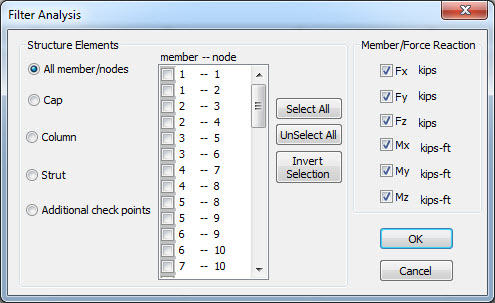

How does one filter Analysis Results so that we can look at limited nodes/members results?
RC-PIER provides the option to select specific member or node and force type to be displayed in the Analysis Window. To select the desired location and force, click Filter button. If filter is not selected, program displays results for all members.
