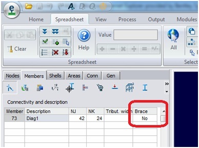

In order to assign a gusset connection in RC for RE, the brace member needs to be designated as a brace. This is done in the Data Panel - Members Tab - Connectivity and Description worksheet. See below. If the Brace flag is set to "No" and a gusset connection is assigned, a "Connection is Not Compatible with This Joint" error will appear. This problem does not occur in RC for RAM SS.
Conversely, if you have a beam to girder or beam to column connection where the secondary beam has been designated as a "Brace" then simple shear and moment connections cannot be applied to that beam. The Brace flag is only intended for vertical braces types.

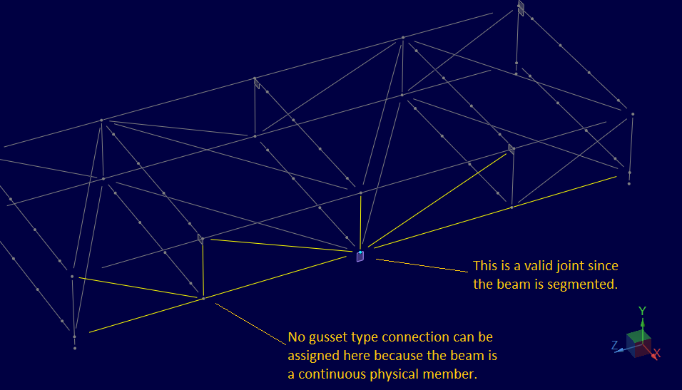

Also, the program is looking for an intersection of a physical beam column and brace, but if the beam or column is a continuous physical member through the joint it won't identify this as a valid condition. In those cases, segment the members at the joint in order to assign gusset plate connections.

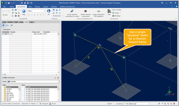

In the case of a Chevron Braced Frame, the beam should also be modeled as a physical member across the apex of the brace joint.

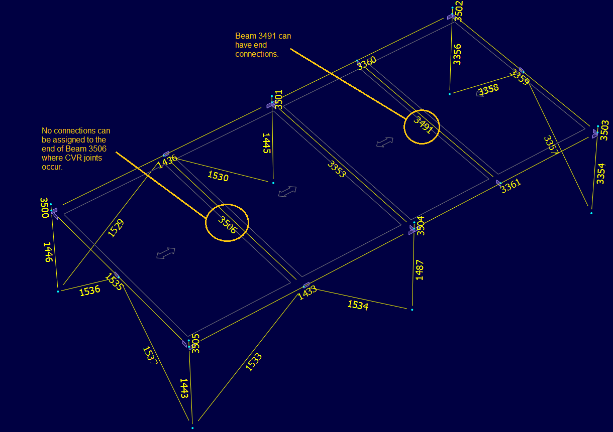

Since there are potential interference issues or requirements for full depth stiffener plates that can't be properly evaluated by the program, Ram Connection simply does not allow connections on beams framing into Chevron Brace (CVR) family of joints.

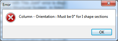

RAM Connection requires that the webs of I-shaped columns in column cap plate connections are parallel to the beam span. In RC-SA, the following error is displayed if the column orientation is changed to 90 degrees:
In RC for RE or RC for RAM SS, a column cap connection will be assigned if the I-shaped column is orientated in the other direction. However, the connection will be displayed and designed as if the column was orientated in the opposite direction.
