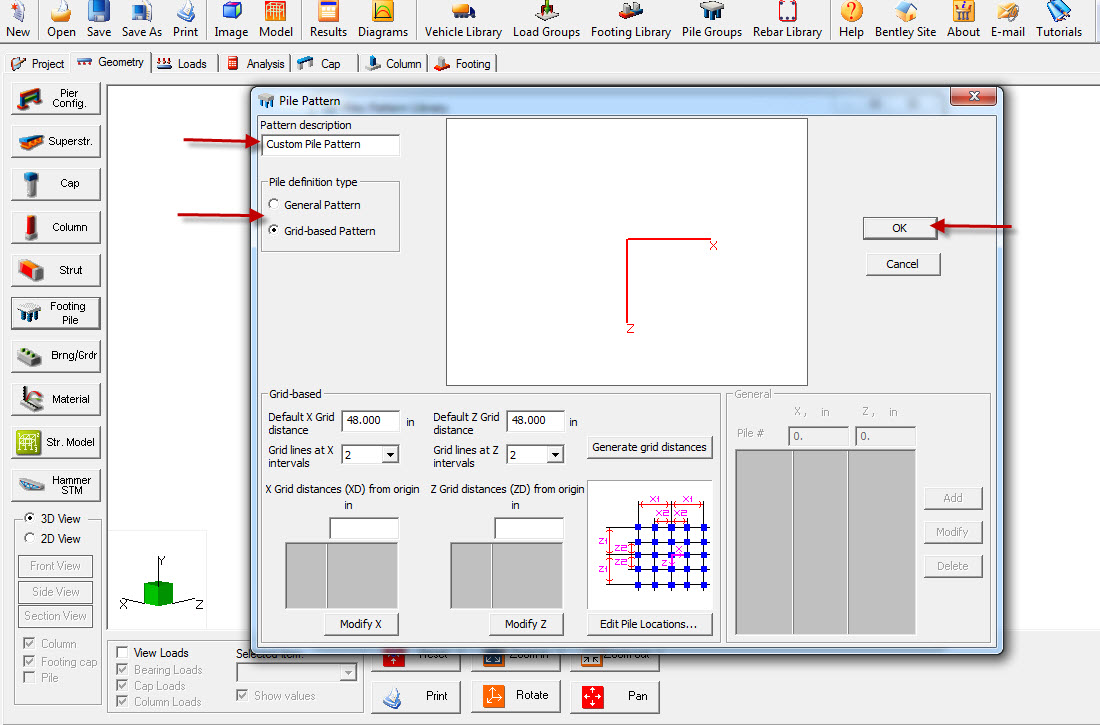

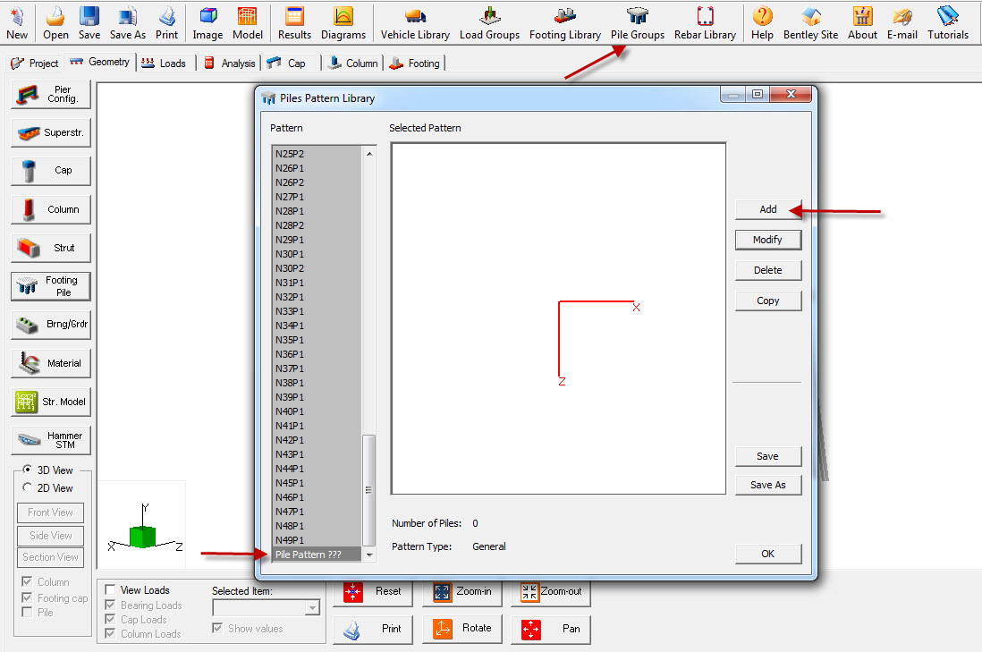

For the user to create his/her own custom pile layout , the user needs to click on Pile Group option on the toolbar.Then Click on ADD button and then the program will generate a default custom Pile pattern name (pile Pattern ???) . Select the name then click on MODIFY option and in the new window "Pile Pattern"  give a name under Pattern description and then user can create layout using 2 options General Pattern or Grid Based pattern.Once the Layout is created the user needs to click on OK button and then Save the Pile Pattern Library.
Please see the attached screenshots .
