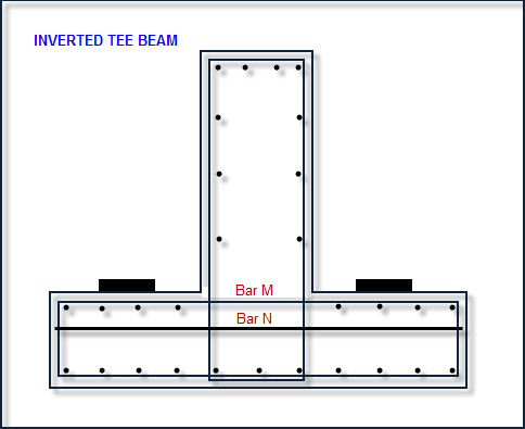

QUESTION: Which equations does RC pier checks for Ledge reinforcement (Bars M & N) calculation of Inverted Tee Cap?
ANSWER:
For Ledge Reinforcement (Bars M & N):
To Determine Distribution Widths :
For Distribution Width for Shear -- AASHTO LRFD 5.13.2.5.2
For Distribution Width for Bending and Axial Loads -- AASHTO LRFD 5.13.2.5.3
For Reinforcing Required for Shear Friction -- AASHTO LRFD 5.8.4.1
For Minimum Reinforcing -- AASHTO LRFD 5.8.4.4-1
For Reinforcing Required for Flexure-- AASHTO LRFD 5.13.2.4.1
For Reinforcing Required for Axial Tension -- AASHTO LRFD 5.13.2.4.2
For Minimum Reinforcing --AASHTO LRFD 5.13.2.4.1
To Check Required Reinforcing -- AASHTO LRFD 5.13.2.4
Please see the attached screenshot.
