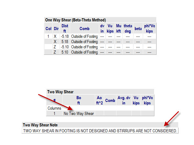

QUESTION: What does the note "No Two way Shear " mean in Leap RCpier Footing design status output ?
ANSWER:
In one of those cases where in if the d/2 value falls outside the footing, then in the footing design status output the program shows “ No Two way shear “ message and also in the program shows the General Note saying TWO WAY SHEAR IN FOOTING IS NOT DESIGNED AND STIRRUPS ARE NOT CONSIDERED “ .Please see the attached jpeg files for more information.
