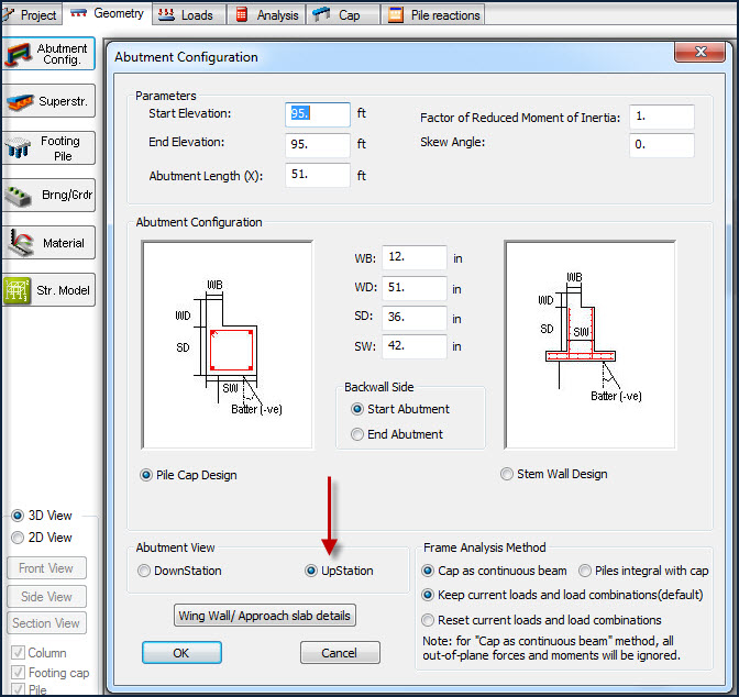

QUESTION: In RCpier program if the user selects Up station or Down Station option in the Abut/Pier Configuration Dialog Box, In the Superstructure Parameter Dialog Box what number should the user input in the span number Rear to current pier input box ?

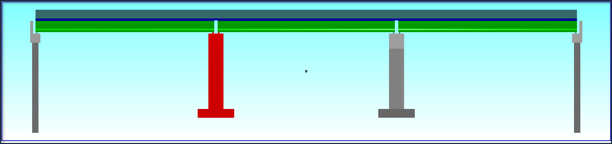

Let’s assume for 3 Span bridge.

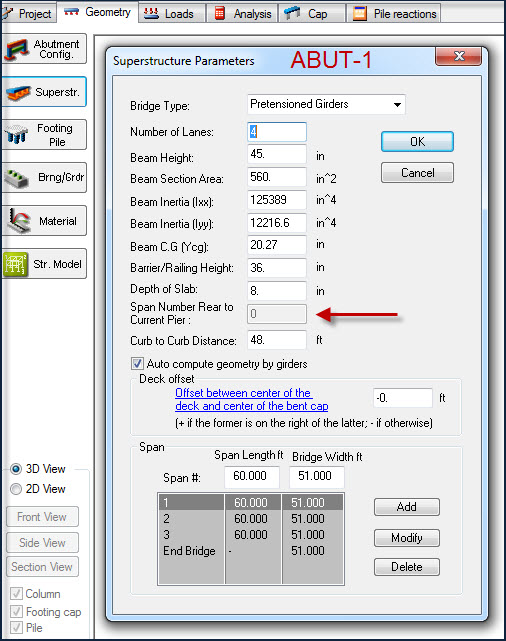

Abut/Pier View -- Up Station :
For the Abutment 1 the Span Number Rear to current Pier is = 0 .

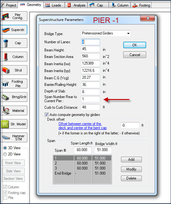

For the Pier 1 the Span Number Rear to current Pier is = 1

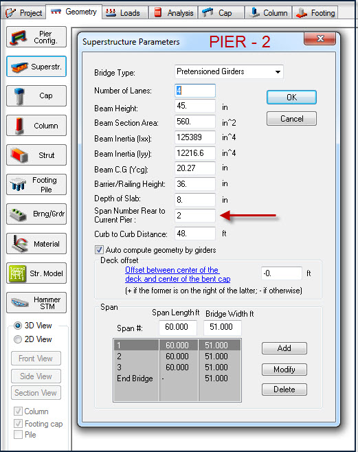

For the Pier 2 the Span Number Rear to current Pier is = 2

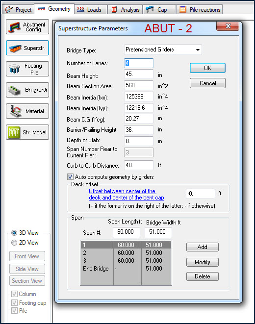

For the Abutment 2 the Span Number Rear to current Pier is = 3
Abut/Pier View -- Down Station :
For the Abutment 1 the Span Number Rear to current Pier is = 3
For the Pier 1 the Span Number Rear to current Pier is = 2
For the Pier 2 the Span Number Rear to current Pier is = 1
For the Abutment 2 the Span Number Rear to current Pier is = 0
Please see the attached Screenshot.
