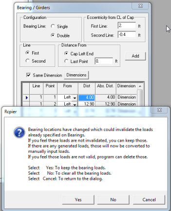

RC-PIER moving bearings may invalidate auto-generated bearing loads
If bearings are moved auto-generated bearing loads are invalidated.  The designer may be presented with a warning message and the option of keeping the bearing loads or erasing them.
