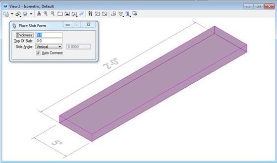

Figure 1 - Use Place Form Tool to Create a 1" x 5" x 24" Plate

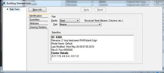

Figure 2 - Apply an appropriate part which includes structural and analytical data.

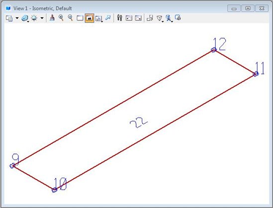

Figure 3 - Review Part and Family in Element Info.

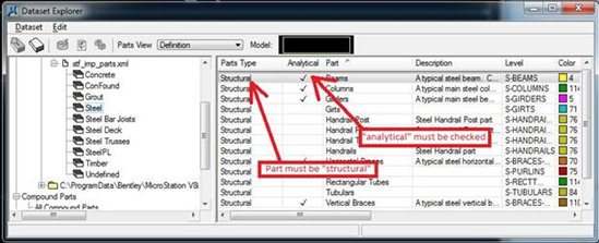

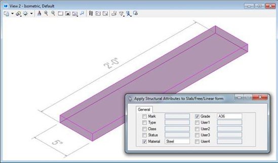

Figure 4 - Apply Structural Attributes to Slab/Free/Linear form

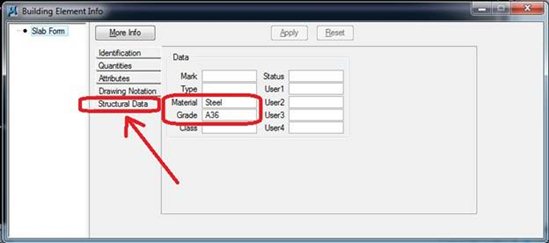

Figure 5 - Review Element Info. AFTER Structural Attributes have been applied and the "Structural Data" tab is now present.

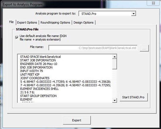

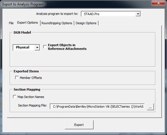

Figure 6 - Preferred Alternative: Export Physical Model to STAAD.Pro

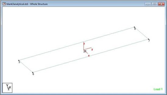

Figure 7 - Shell Elements are Written to the STAAD.Pro file
Figure 8 - STAAD.Pro model viewed in STAAD.Pro

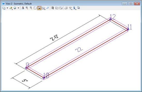

Figure 9 - Alternative #2: Toggle analytical features on and "Apply Structural Attributes".  A 2D plate is created in the DGN model.
Figure 10 - Plate in DGN model in Pure Analytical View.

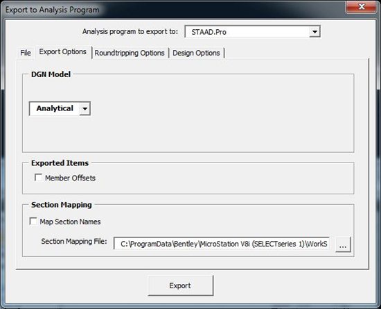

Figure 11 - Export to STAAD.Pro using Analytical option
