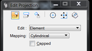

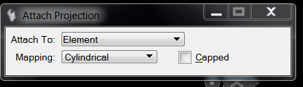

1. Open material projection tool.
2. Attach object
3. Edit projection
