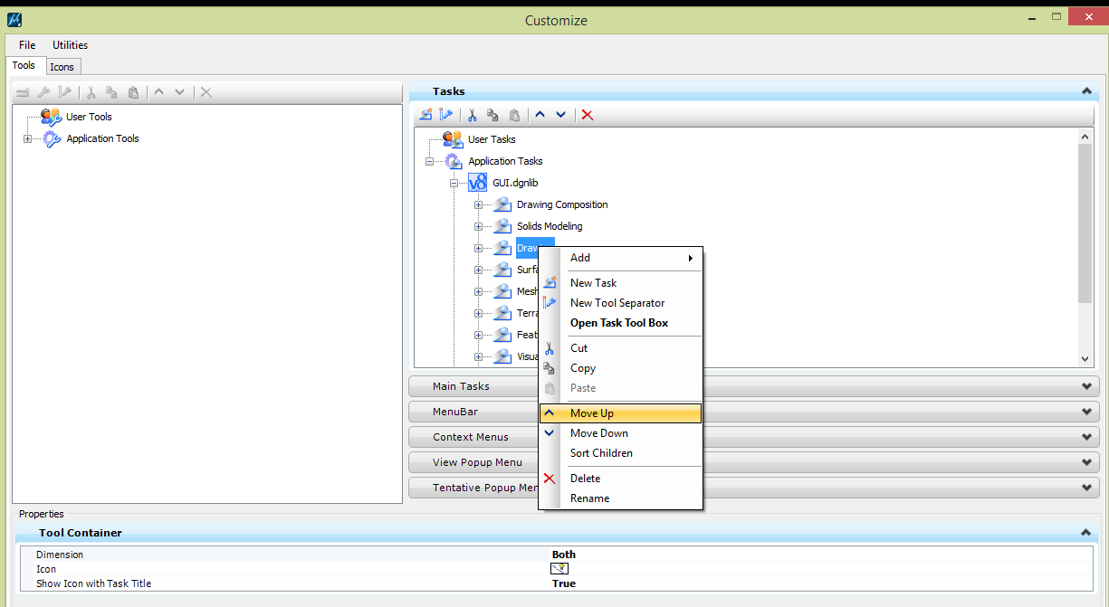

How to change order of tasks in tasks menu
  1. Open the ****.DGNLIB used to customize your GUI.
  2. Workspace > Customize > Task
  3. Right click on the task that you would like to move and press Up or Down until it is in postion.
  4. Save Settings > Save and close the .dgnlib
Next time you open a dgn or dgn file your tasks will be organized in the order you made in the .dgnlib
