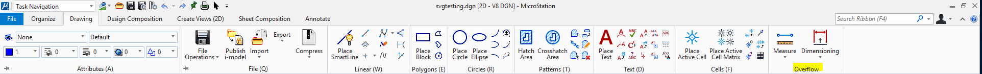

Background: The ribbon in the CONNECT Edition is highly customizable. Some users, especially those with wide or ultra-wide displays may want to have access to a larger number of groups. After a number of groups are added to a tab an overflow group is automatically created containing any added group to that tab:
Fig 1.

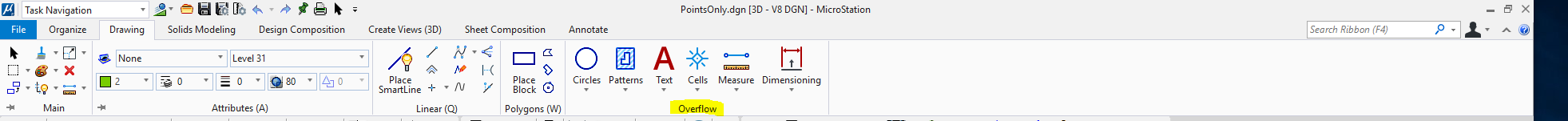

Change the value of MS_RIBBON_NUMEXPANDEDTASKGROUPS.
Fig 2. Same ribbon as fig. 1 with MS_RIBBON_NUMEXPANDEDTASKGROUPS=8

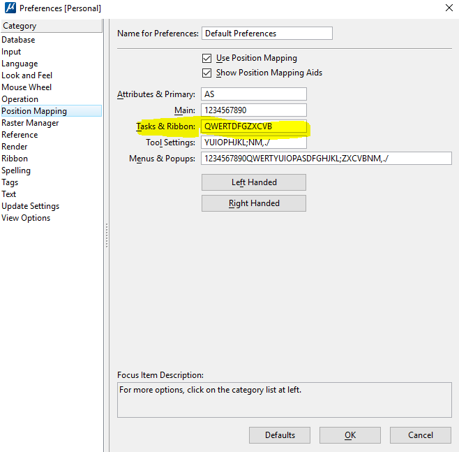

By default the value is set to 8 you can increase this to a number required. Note that if you are using position mapping you may want to limit the number to the number of available position mapped keys.
