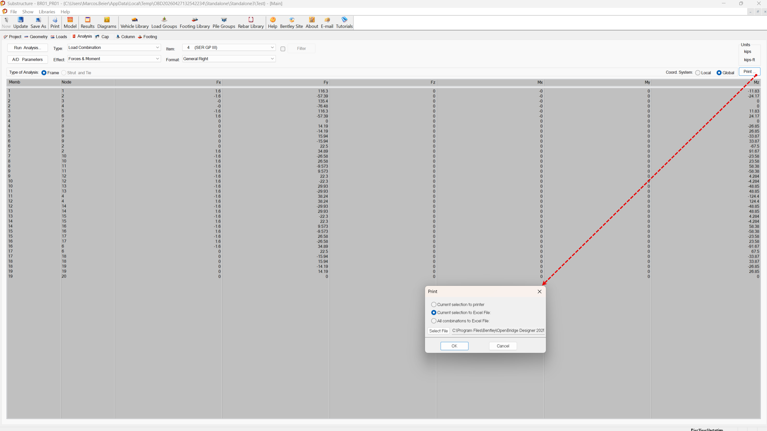

Export analysis results to Excel under Substructure design
Exporting analysis results to Excel is available under the Print on Analysis dialog, as shown in the screenshot below.
