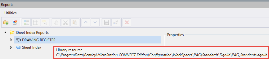

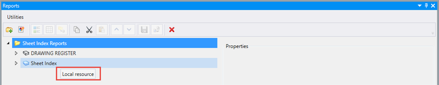

To establish if the Sheet Index Report is a local or library Report, open the Reports Dialog and move the cursor over the Report Definition name and the popup will display where its located

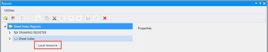

1 Changing the order of Report / Table columns in the active file
  1. Place a Sheet Index Report as a Table into the Design
  2. Open the Reports dialog
  3. Expand the Report Definition to expose the define Columns
  4. Select the Column to relocate within the Report Definition
  5. Select the 'Move Up' or 'Move Down' to reposition Column as required
  6. Select the Table in the design and use the 'Refresh Table from Datasource' tool to update the Table with the changes made in the Report.

2 Overriding the Columns on a Report Definition / Table coming from a configured dgnlib.
  1. Place a Sheet Index Report as a Table and in the Tool Settings dialog select a configured Report definition to use.
  2. When the Table is placed a copy of the Report definition is made in the active file making it a local definition which can then be edited as above. (Note however this is overriding the standards set by your Site Administrator)
