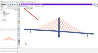

RM Bridge: Analyzer Recalculation window

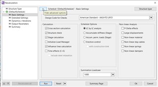

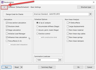

RM Bridge Enterprise has many possible options to be set in the Recalculation window. If the button Show Schedule Variants and Advanced Options, highlighted in red below, is selected, we can see the Recalculation options main menu with:
    Structure type
  1. Basic Settings
  2. Extended Settings
  3. Dynamics/Interactions
  4. Output Parameters
  5. Summary
