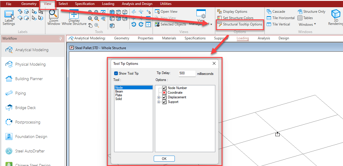

In the past when I hovered over the beams or nodes, I was able to see lot of information like node numbers, displacements, coordinates for nodes and beam numbers, properties, end forces, ratio for beams. Now I only see the node and beam numbers. How can I get back the old setting?
You need to go to the top ribbon menu and choose View > Structural Tool Tip options and you will find a number of check boxes using which you can turn on the items that you want to be displayed.
