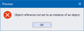

QUESTION: Getting "Object reference not set to an instance of an object" error when generating Deflection Check Report.

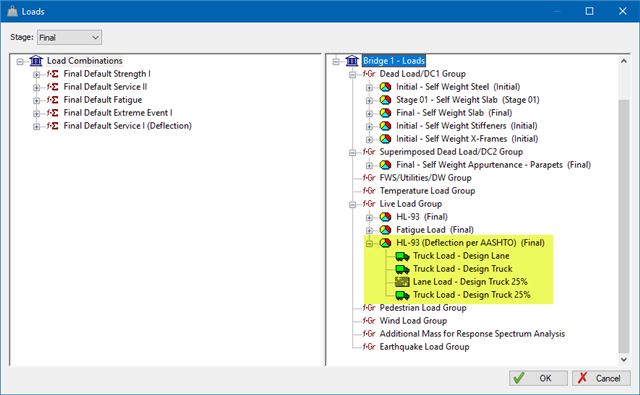

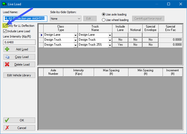

- Make sure you have the Deflection Live Load under the Live Load group. If you don't have one please create one with the option "Only for LL Deflection" toggled ON and you have selected the desired Live Loads:

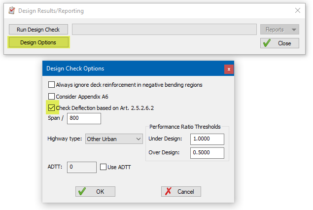

- In the Design Results/Reporting dialog open Design Options and toggle ON "Check Deflection based on Art. 2.5.2.6.2" and then Run Design Check.

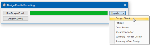

- Then Open Reports > Design Check and run the "Deflection Check Report"
