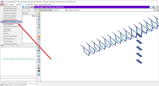

Save TCL Export Data
At the top ribbon menu option, in File, users will find the Save TCL Export Data to export only the specific RM Bridge project data: this will store the data of the project database in ASCII format into a TCL file. TCL-Files are used for backup, text-based editing of project data, and as an extension of the RM Bridge environment as a fully comprehensive script language. The export to a TCL file may be done either for the complete project or only for parts of the project. The parts to be exported can be selected in the related input pad. All parts are per default selected.
Another possibility is to use the main menu button, more about it can be found at the link below:
communities.bentley.com/.../rm-bridge-tcl-file
