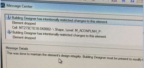

Opening a file in MicroStation or MicroStation PowerDraft and trying to manipulate elements launch message "Building Designer has intentionally restricted changes to this element"
Explanation
The model was created with AECOsim Builder Designer  and it is a normal behavior that when these type of  files are opened in plain MicroStation you get the message ”Building Designer has intentionally restricted changes to this elements”
These elements are locked for edition so they can just be edited in AECOsim. In order to Edit these elements in MicroStation we need to do some changes from AECOsim Building Designer.

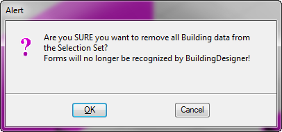

3 – Enter the key-in “tfremove”
4 – Click “OK” in the next dialog box:
Important notes:
If the model has existing Cells created with AECOsim (as for example cell STF Steel Truss) before using the command “tfremove" we need to separate these elements. To perform the separation you must select the cells first and then use the tool to separate elements using the complex option.
Once this is done we can use the command “tfremove" and make clic on OK.

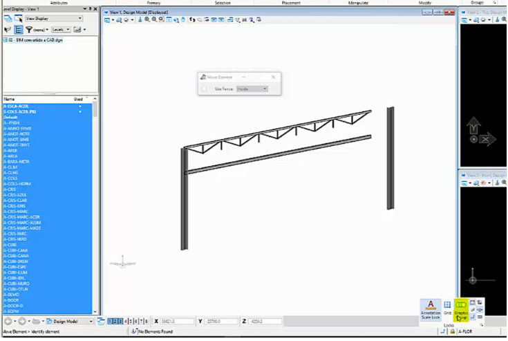

Now you can open the file in MicroStation and in order to manipulate the elements you need to disable graphic groups. See image
