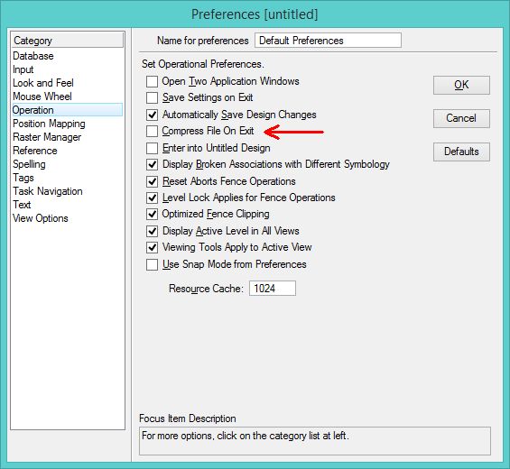

-"Compress on Exit" Preference checked on
Menu item: CWorkspace > Preferences > Operation: "Uncheck "Compress File on Exit" (workaround: manually compress).

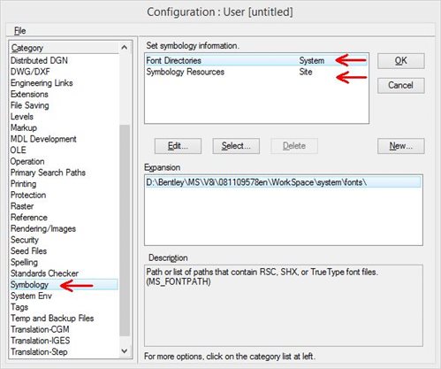

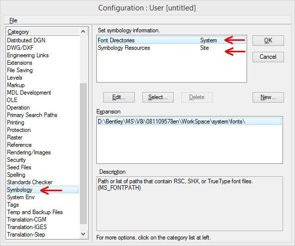

-Bad Resource File
Remove RSC files from the MS_SYMBRSRC + MS_FONTPATH and replace one at a time until
exception crash returns. (Menu item: Workspace > Configuration > Symbology)
