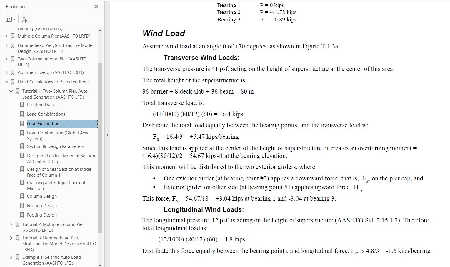

Wind Load hand calculations under Substructure tutorials
Wind Load hand calculation example is available under Tutorial 1 of Substructure (former RC-PIER) (see screen shot below)
