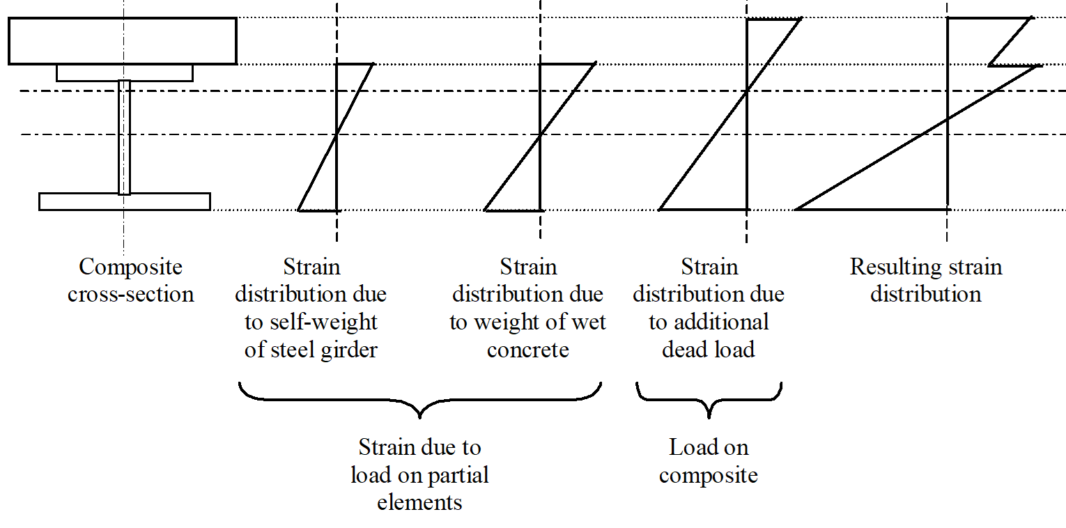

Composite structures loads considering the erection sequence in the simulation with partially completed elements has a complex structural system that changes in time and requires a non-linear stress distribution as shown in the picture below.
Comp strs

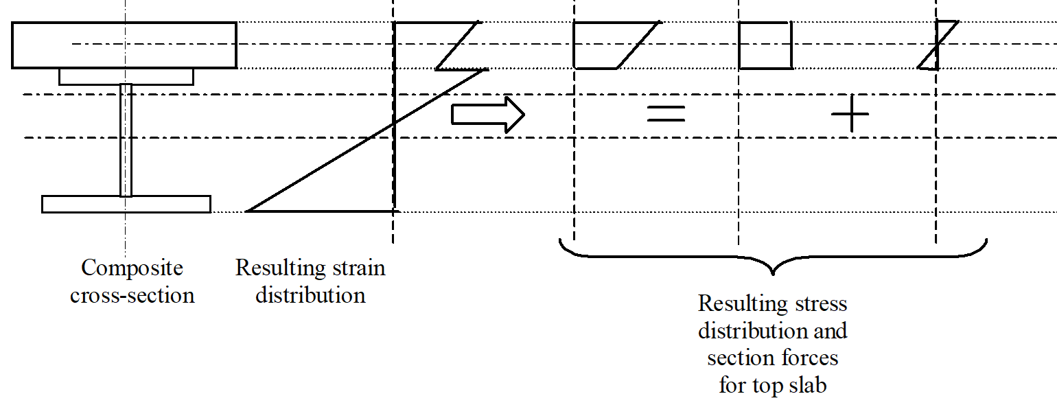

This requires the conversion of accumulated section forces into equivalent for each individual component, split:
split
It also needs the individual parts to be converted into full Cross-Section, join:
Join
