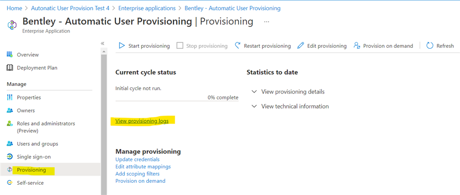

How to locate the logs for Microsoft Azure AD User Provisioning
1. Go to the Azure Portal and select Azure Active Directory
2. Select Enterprise Applications from the left then select the Bentley Automatic User Provisioning app from your list
3. Under Manage on the left-hand menu select Provisioning
4. Select “View provisioning logs”
