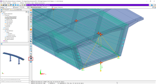

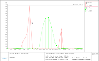

For the output of this action, User can have access to results presented in a *.lst file and perform the plot diagram, with the total area value obtained, throughout RM Sets.
By Attribute Sets definition and recalculating the reinforcement layout, User can either display the distribution of the total reinforcement area value, in the cross-section:
