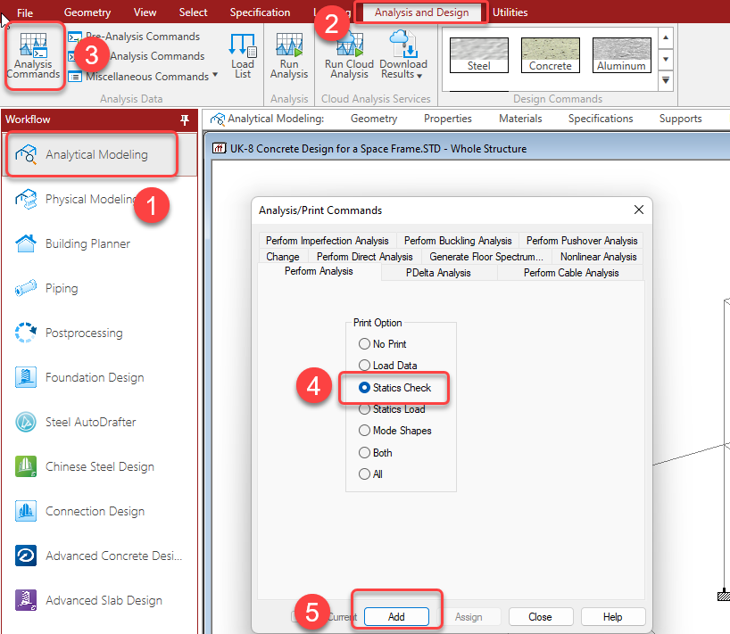

If you prefer to use the graphical method for specifying this option, this is how it can be done.
In the Analytical Modeling workflow, go to Analysis and Design > Analysis Commands in the ribbon menu. A Perform Analysis dialog box will be displayed. Set the radio button on Print Statics Check. Click on Add.
Save the file and run the analysis. Then view the output file. (This can be done from Utilities > Analysis Output menu). If you scroll down to the region where the PERFORM ANALYSIS command is specified, the equilibrium report will be available after that command.
