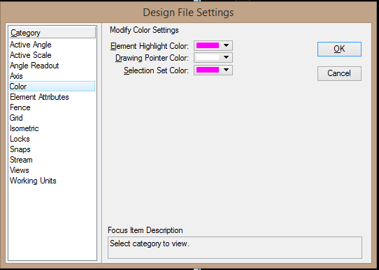

-Ensure that the Element Highlight Color is set to a colour that will display:
Settings>Design File>Design File Settings>Color Highlight colour is set to magenta.

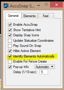

-Ensure that Identify Elements Automatically setting is checked in Accusnap
-Ensure Pop-up Info is enabled or disabled through AccuSnap Settings.

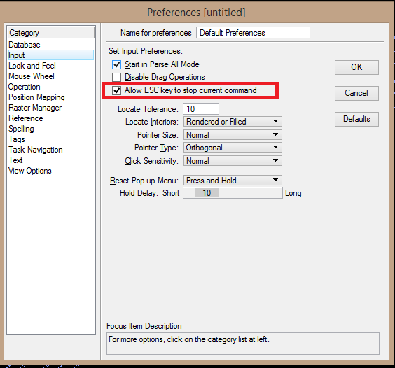

-The following setting may need to be enabled:
Workspace > Preference > Input Turn On the "Allow ESC key to stop current command"
then "OK" Save Settings.
The command will then remain highlighted until ESC is selected.
