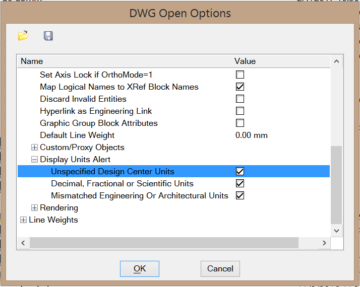

For MicroStation 2004 and newer versions
In order to re-activate the DWG Units dialog, go to
File>Open.
-Select .dwg as the File type which will activate the DWG Options button.
-Click on the DWG Options button.
-Go to Advanced>Display Units Alert.
-Select all three options under this heading to ensure that the DWG Units Alert dialog is restored. Press OK.
Note - Like in older versions of MicroStation, you can also opt to rename the DwgSettings.rsc file located in the below path (defined by MS_DWGDATA):
C:\Users\<user name>\AppData\Local\Bentley\MicroStation\XX.0.0\prefs\dwgdata\DwgSettings.rsc
However, keep in mind that resetting this file will also reset other aspects of DWG Open and Save As DWG options.
