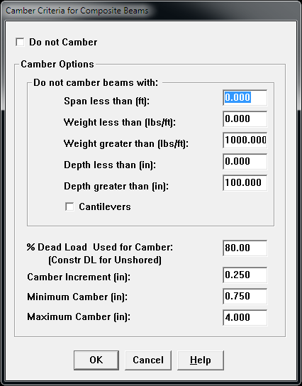

The Criteria - Camber and Criteria - Deflection Criteria together determine if steel beams will be cambered in the program design. Refer to the Ram Steel Beam manual for details on exactly how this is done, below is an example for the most common case, Unshored, Composite Construction.
This example uses default camber and deflection criteria:
Which means that beams will be cambered if and only if, the deflection from 80% of the applied Construction Dead Load is greater than the Minimum Camber of 0.75".

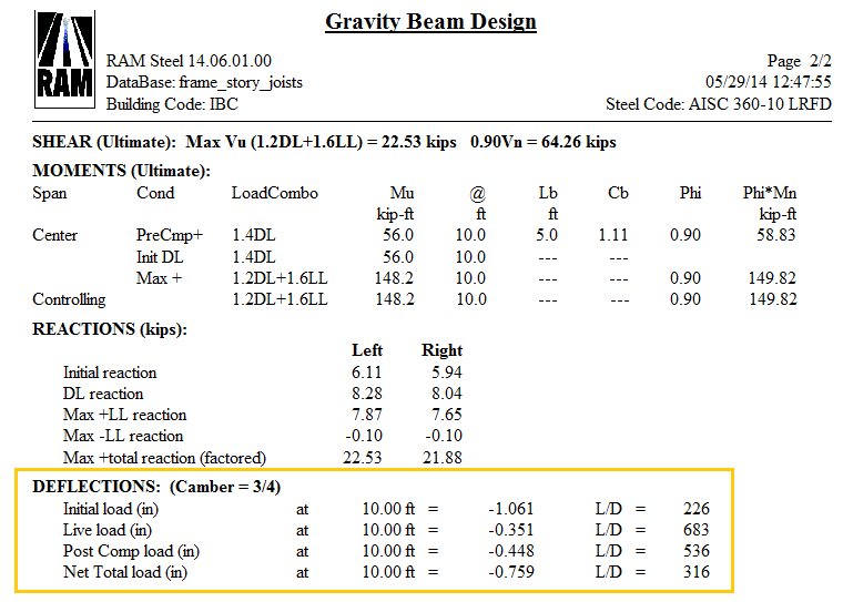

The beam in question is a 20' long girder and the CDL stems from the beam and deck self weight. With 100% of that load considered acting on the pre-composite unshored beam, the deflection is 1.061" downward at mid-span. The deflection due to 80% of the CDL is therefore 0.8 * 1.061 = 0.85". Thus, the program cambers 0.75" which is 3 times the 0.25" camber increment.
The Live load deflection is calculated using the composite properties (Ieff) and is therefore a smaller total deflection even though the applied loads may be more than the CDL. This Live load may already be reduced if the beam tributary area is large enough. Construction live loads are used in the Pre-composite strength check of the beam only, not in the initial deflection check.
The Post Composite value is also based on the composite beam effective inertia. The Post Composite load considered is any dead load above and beyond the CDL plus the Live Load. This is often referred to as the superimposed load.
Thus, the Net Total load can be calculated using the formula:
Net Total deflection = Initial defl + Post Composite deflection - Camber
In the case above that is
0.759 = 1.061 + 0.448 - 0.75
It's also worth noting that the initial deflection in this case is large enough to surpass the common L/240 deflection limits for dead loads, but that's OK because there is no limit on initial deflections (using our default deflection criteria). So long as the Live load deflection and Net Total deflection limits are OK, no warning will be given.
Even with camber, this beam theoretically deflects 1.061 " - 075" = 0.311 inches during construction. The program does not increase the construction dead load to account for the additional topping concrete that might occur from such ponding. The applied loads should manually be increased where this is a concern.

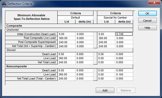

Can I turn off Camber on specific beams?
The Criteria - Camber controls whether to camber or not camber composite beams or non-composite beams for the whole model. In cases where you want no camber on specific beams consider adding a special set of deflection criteria with an initial deflection limit equal or less than the minimum camber and assign that deflection criteria to the beam in question:
