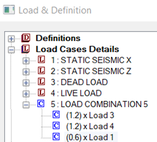

How to create Load Combination using OpenSTAAD functions
You need to use function CreateNewLoadCombination to create new load combination with the number and title defined. Then AddLoadAndFactorToCombination needs to be used to add a primary load case with specified multiplication factor to an existing load combination.

Sample VBA Syntax:
Set objOpenStaad = GetObject(, "StaadPro.OpenSTAAD")
Dim LoadCombTitle As String
Dim LoadCombNo As Long
Dim PLoadNo(2) As Long
Dim Factor(2) As Double
LoadCombTitle = "LOAD COMBINATION 5"
LoadCombNo = 5
PLoadNo(0) = 3
PLoadNo(1) = 4
PLoadNo(2) = 1
Factor(0) = 1.2
Factor(1) = 1.2
Factor(2) = 0.6
objOpenStaad.Load.CreateNewLoadCombination LoadCombTitle, LoadCombNo
For i = 0 To 2
objOpenStaad.Load.AddLoadAndFactorToCombination LoadCombNo, PLoadNo(i), Factor(i)
Next i
Output:
Array can be used for variable LoadCombTitle and LoadCombNo to generate multiple load combinations
