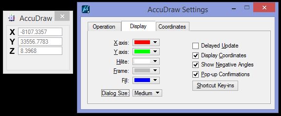

The AccuDraw dialog can be re-sized to either a Small, Medium or Large size.
MicroStation CONNECT/202X
Drawing Workflow > Drawing Aids Tab > AccuDraw Ribbon Group > Accudraw Settings > Display Tab and then change the Dialog Size
MicroStation V8i
Settings > AccuDraw > Display
and then change the Dialog Size.

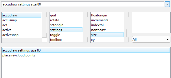

To double the size of the AccuDraw Compass, use the keyin:
accudraw settings size 80
The default size is 40 pixels.
The entered value should be in the range 6-399.
