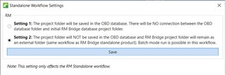

We created one additional Settings in OpenBridge Designer to allow users to modify their Standalone Workflow to run RM in Batch mode. This is accessible thru File\Settings as shown in the screenshots below. Batch files or programable .tcl files allow several runs to be performed in parallel and are useful for long dynamic analysis and for optioneering with different project configurations.
OBDFile  OBDSettings
More technical information about this option for the Standalone workflow of RM Bridge can be found at the link below.
