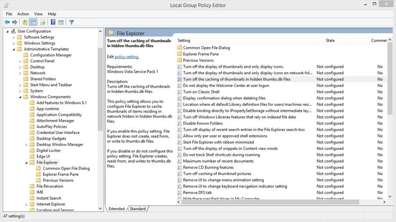

•  Click Win+R and type gpedit.msc in the Run window to load the “Local Group Policy Editor”.
•  Select User Configuration > Administrative Templates > Windows Components > File Explorer

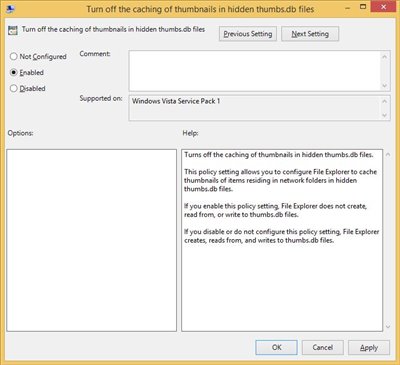

•  On the Right side double click “Turns off the caching of thumbnails in hidden thumbs.db files
•  Select “Enable” and click “Apply” and “Ok” to turn off creation of thumbs.db
