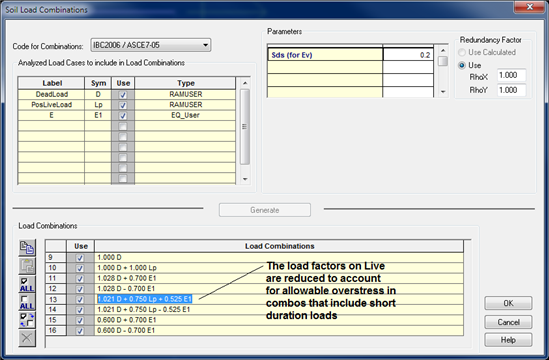

How is 1/3 overstress accounted for?
The allowable soil stress assigned to the footing is constant for all combinations. So, there is no good way to accommodate 1/3 allowable overstress in the design if it pertains to some, but not all of the load combinations.
We suggest incorporating the equivalent allowable overstress into the soil combos, by using reduced load factors on the combos with short duration loads.
Alternatively, the model could be designed twice; once with only gravity combos and a lowered allowable soil stress, once using gravity and lateral combos with the higher allowable.

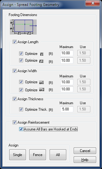

Why does the required area of steel increase when I use larger diameter bars?
In small foundations, the longitudinal bars are only partially developed at the critical moment location. When the program reports the area of steel required it is increasing the value reported by dividing by the percentage of full development. This is also true for reinforcement that is required as a code minimum for temperature and shrinkage. With smaller bars the development length is shorter so less net area of steel is commonly required.
This check can be circumvented by assigning the bars to be hooked (Assign - Geometry command)
The same rule also affects continuous footings in the transverse direction.

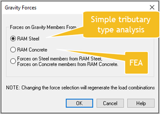

Why are there two options for the forces from gravity columns only?
The Criteria - Forces dialog has an option for the Gravity load forces to use for gravity column foundations:
But, of all the Analysis Types we do in RAM Structural System, only Ram Frame produces results for lateral loads (Wind, Seismic, etc). To maintain consistency in the stiffness matrix we therefore always use the forces from Ram Frame for lateral column (and wall) foundation design.

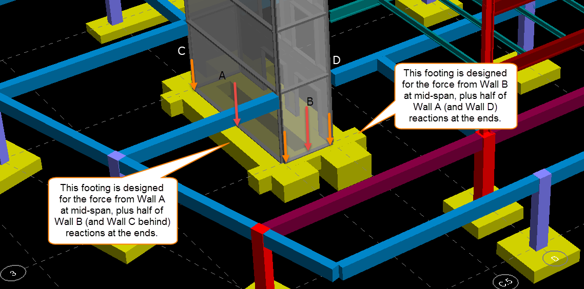

Why are the continuous foundations so wide for very long walls?
In RAM Foundation, all of the force of a wall segment is applied to the continuous foundation at the center point of the wall. When a wall intersects a footing (i.e. a perpendicular wall), the forces on the walls are resolved into two end reactions considering the wall segments as a simple beam. Having a large reactions from a perpendicular wall near the end of the footing often results in a long continuous footing extension.
To minimize these effects, walls can be further segmented in RAM Modeler. So instead of drawing one 100 foot wall, four 25 foot walls can be drawn in its place. Naturally the smaller the segments, the better distribution of load you will get.
For shorter walls in groups, like an elevator core, we recommend modeling a single mat foundation under the group of walls and designing that with Ram Concept.
