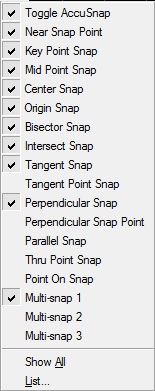

In the Snap Mode tool box Button Bar various options are missing.
Right click on tool bar and make sure that the buttons
that you want to show have a check on the left side.
