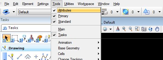

Toolbox showing the active attributes, e.g Active Level, Color, Line Style, Line Weight is suddenly missing.
Please go to the main menu Tools > Attributes and turn it back on as shown in the image below

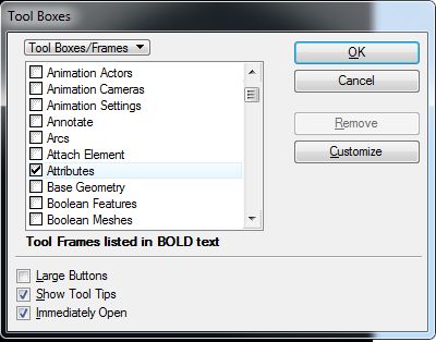

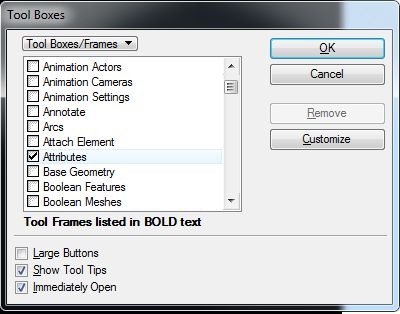

Other option how to have this toolbox displayed is to go to Tools > Tool Boxes > Attributes and tick the option as shown in the image below:
