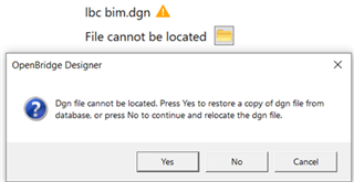

Previously, however, .obdx file was storing the most up-to-date copy of the OBM .dgn file. In case the external .dgn file cannot be located, user will be asked if the .dgn file should be restored from .obdx database.

If the user has the .dgn files alongside the exported .obdx file, then OBM will show them in the project tree explorer. If the .dgn files are not available or they are stored in another location than the one used by the initial .obd file, OBD will show an alert that the file is not found. In this case, if the user:
- has access to the .dgn files, he can browse to that location and reassign the paths
- does not have access to the .dgn files, he can restore a backup of the initial .dgn file that was created when the export to .obdx file was executed.
