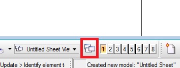

I use View Groups in my project and I want to change the names of those View Groups.
1. Go to the Manage View Groups dialog box by clicking the following icon at the bottom of the design window.
2. Click 'Edit View Group Properties' by clicking on the following icon in the Manage View Groups dialog box.
3. A small window will appear with the option to edit the Name and the Description of the View Group. Change the name to what you would like. Click OK and the name will automatically change.
