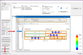

QUESTION: How to get the Lane load details and location of Vehicle and UDL?
ANSWER:
In Leap Bridge Steel please Run the analysis and once the analysis is done please click on Lane Load Details Button.
In the new Lane Load Details Dialog Box , please select the Member , Load case and under Influence Surface group please select for what type of information (Moment , Shear , Deflection….) the user wants to see the location of the vehicle and the UDL.
Once the ISG type if selected, user can select the POI to see the exact location of the vehicle and the UDL.
