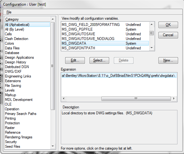

Problem may be caused by a changed DwgDisplayColors.tbl in the dwgdata directory. (The dwgdata directory is the directory MS_DWGDATA points to.)
This file can be deleted when MicroStation is not running and will be recreated.
