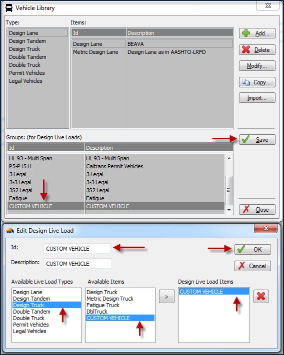

User can apply Custom Live Load in Leap Conbox and please follow this procedure .

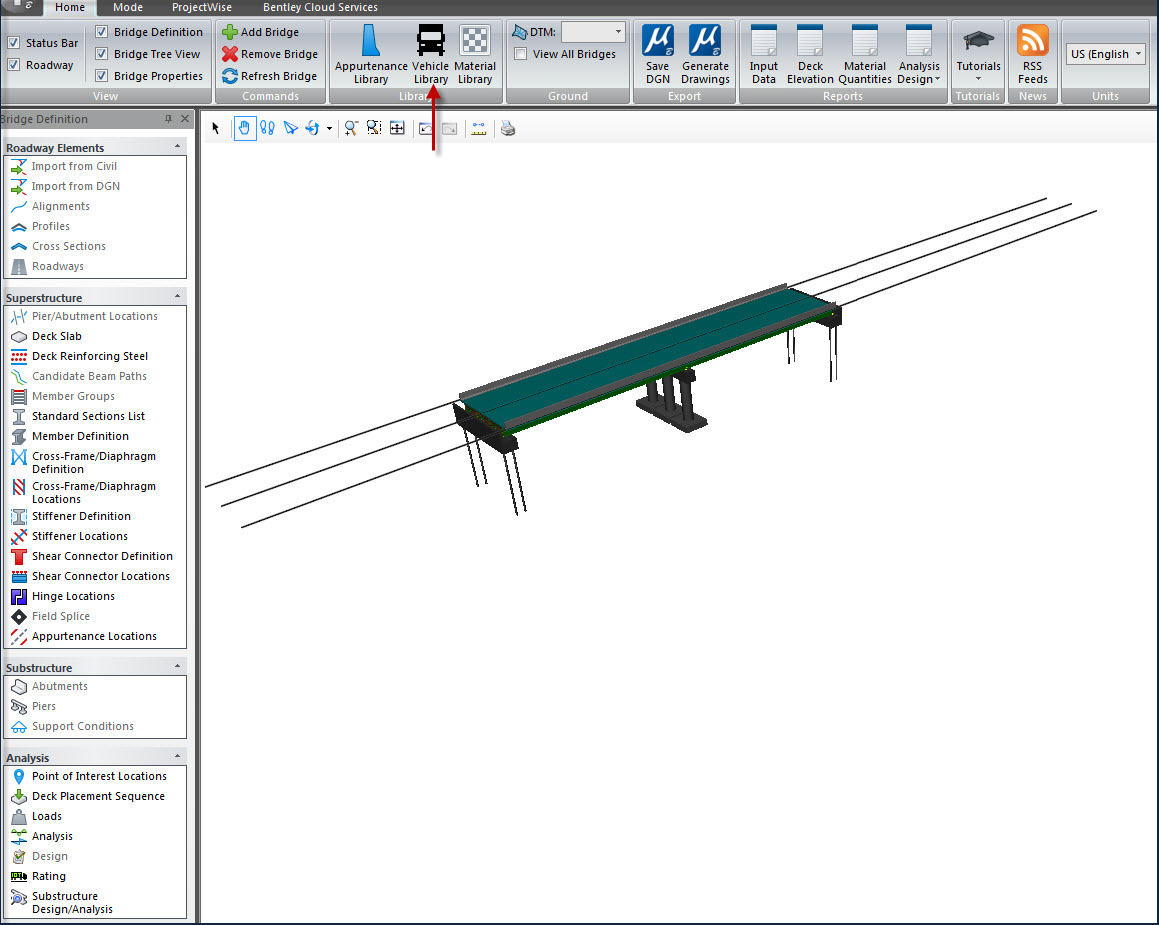

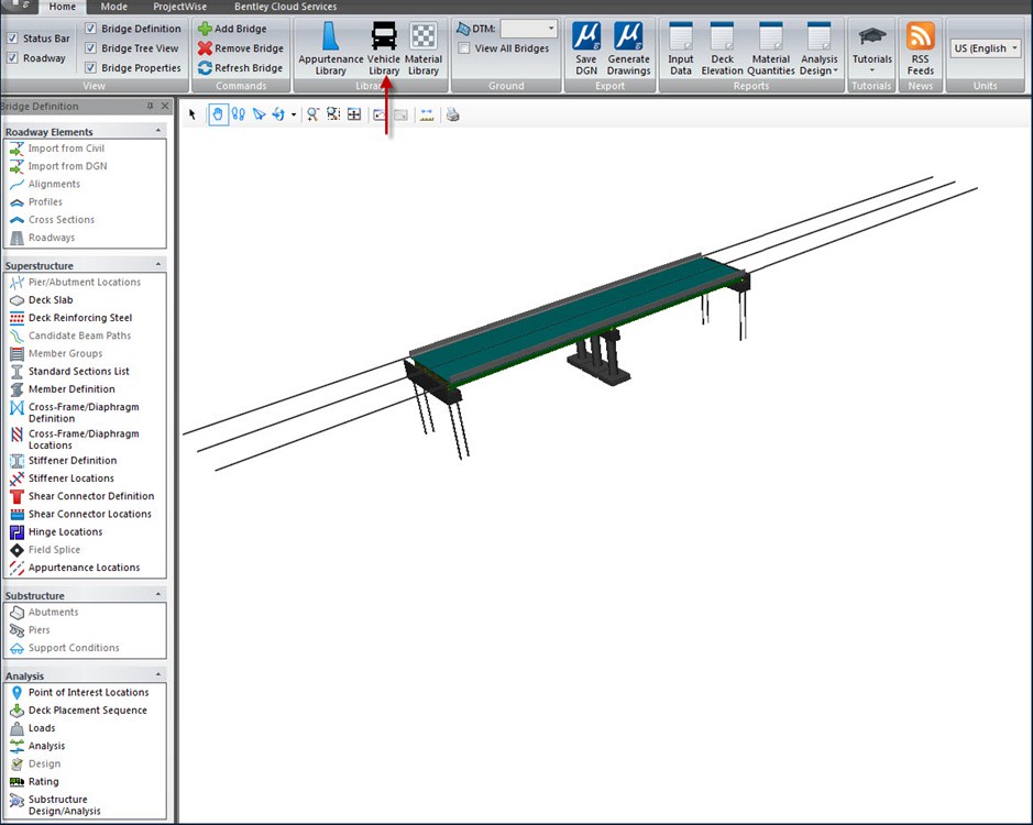

1) User needs to model the Steel Bridge in Leap Bridge Steel Program
2) Then in Leap Bridge Steel program user needs to click on Vehicle Library option on the toolbar .

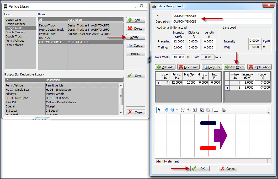

3) In the Vehicle Library window user needs to select Design Truck and then click on Add button.
4) In the new Edit- Design truck window user needs to input all the relevant information related to Custom Live load.
5) In the Vehicle Library dialog box user should be able to see the new Custom Live Load being added.

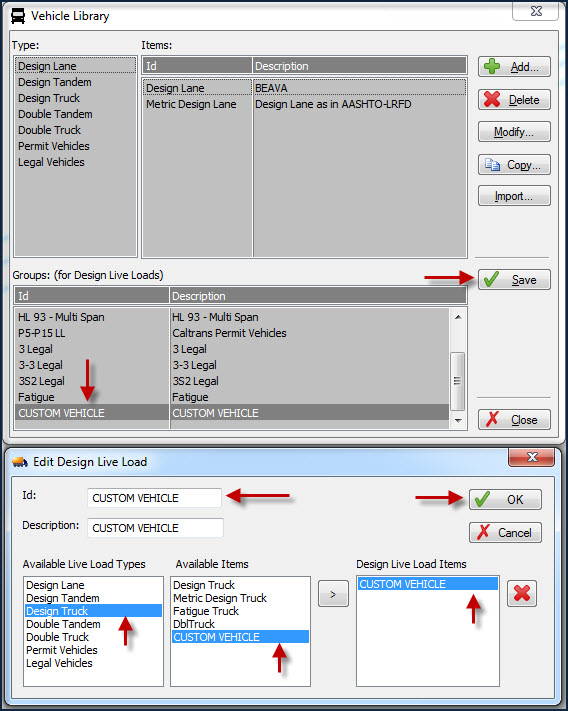

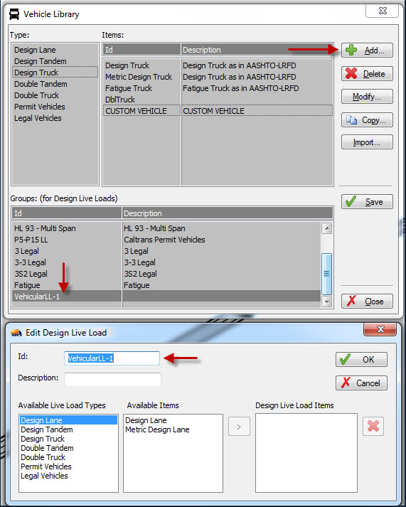

6) Then in the same vehicle Library Dialog Box user needs to select a vehicle ID under Heading Type Groups : (for Design Live Loads) and then click on Add button.
7) Program will generate a new ID named "VehicularLL-1" and the user needs to double click on this ID.
8) In the new Edit Design Live Load dialog Box user needs to input the ID and Description of the Live Load and then under "Available Live Load Types" user needs
     to select Design Truck and then under "Available Items" user needs to select Custom Live Load and then add it under Design Live Load items heading , then click OK.
9) In the Vehicle Library dialog box user should be able to see the new Custom Live Load being added under Design Live Load.
10) Then Save the Library File.

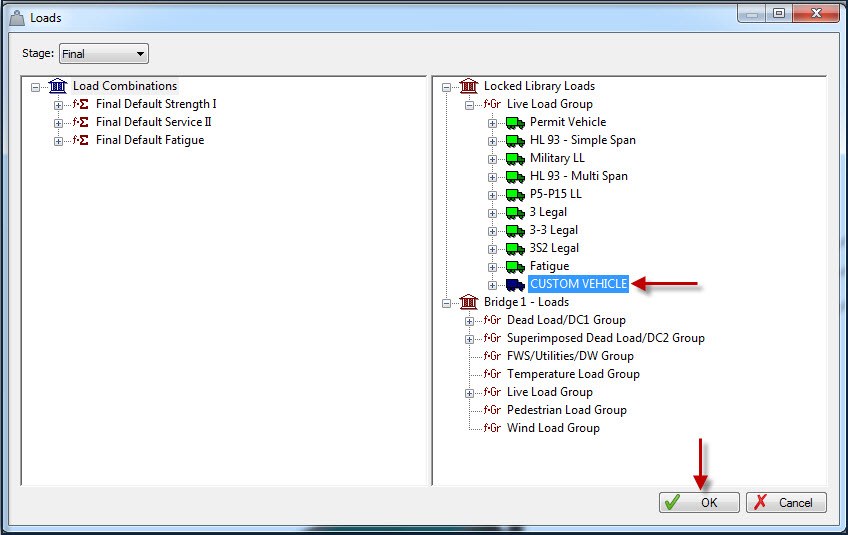

11) In the Load/Analysis TAB user should be able to see the Custom Load option under Locked Library Loads --> Live Load Group.
Please see the attached screenshots for more information.
