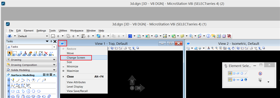

Moving views between two application windows
If we go to WorkSpace > Preferences > Operation > Check "Open two application windows". We can move the toolboxes but we cannot move the views from one screen to the next one.

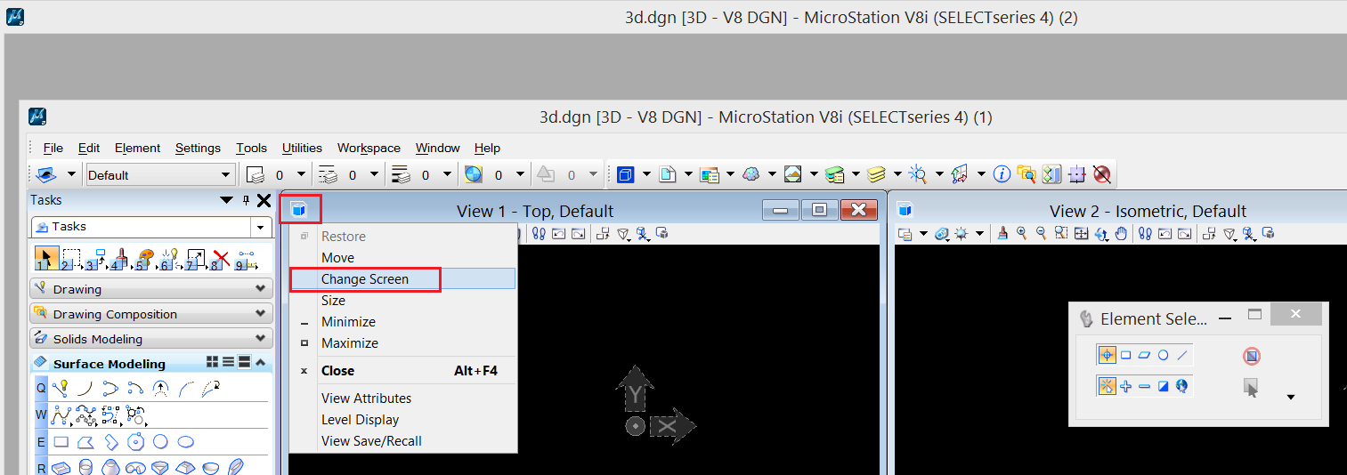

Left click on the square located on the left upper corner of the View 1 (or desired View) and choose "Change Screen":
That View will be moved to the second application window.
