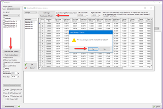

Click on Analysis à In the new Analysis window click on “Live Load Distr. Factor” button.
Click on “Recalculate all factors”, the program will automatically generate the LLDF.

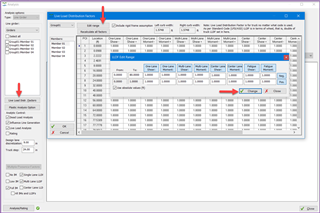

Click on Analysis à In the new Analysis window click on “Edit Range” button.
Manually input the LLDF and then click on CHANGE.
The program will populate the LLDF values in the Table for Moment, Shear and Fatigue.
