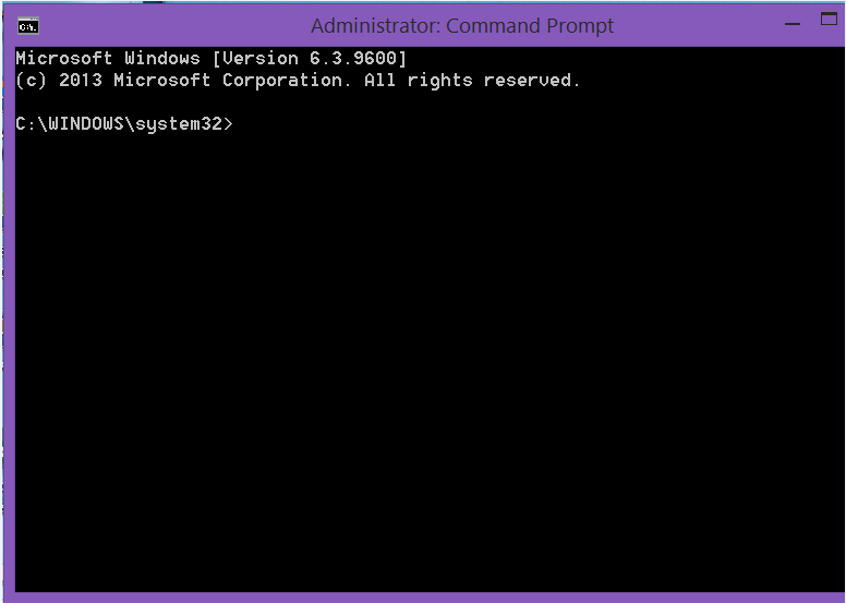

3. Option
Other possibility: from Windows 8 Start-> Command Prompt (admin) paste command line (msiexec /i {7E9B0F70-EEF6-41E1-BF89-FDC4B9EDBD9C} REINSTALL=ALL REINSTALLMODE=omus /qb )
and press enter, this will use the SS2 product code to find the MSI that is cached on the machine and repair the MicroStation installation.
see screen shot
