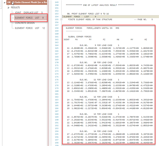

How to see a report of the element force at the nodes of each plate?

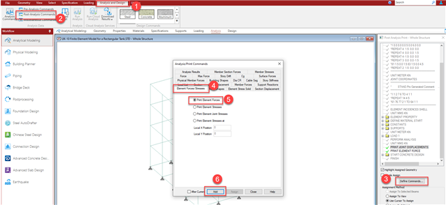

The forces of each node of the plate can be printed in the Output file only. To do that, a PRINT ELEMENT FORCE command needs to be added into the input file after the PERFORM ANALYSIS command. This can be done by following these steps in the Graphical User Interface:
1) Go to Analysis and Design menu;
2) Click on the Post-Analysis Commands button;
3) Click Define Commands...;
4) Select Element Forces/Stresses tab;
5) Select Print Element Forces option'
6) Click Add.
Now this command can be assigned to the required plates in the model. After the analysis, the plate corner forces can be reviewed in the Output (.ANL) file only:
