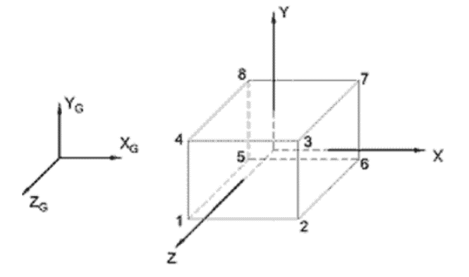

LOCAL COORDINATE SYSTEM OF SOLID ELEMENT
SOLID STRESS OUTPUT

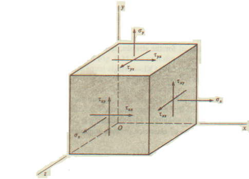

SOLID STRESS OUTPUT
(NORMAL STRESS)
•Positive values for SXX, SYY and SZZ indicate tensile stresses.
•Negative values for SXX, SYY and SZZ indicate compressive stresses.
SOLID STRESS OUTPUT
(SHEAR STRESS)
•A positive SZX is on plus Z face in plus X direction.
•A positive SXZ is on plus X face in plus Z direction.
•A positive SZY is on plus Z face in plus Y direction.
•A positive SYZ is on plus Y face in plus Z direction.
•A positive SXY is on plus X face in plus Y direction.
•A positive SYX is on plus Y face in plus X direction.
