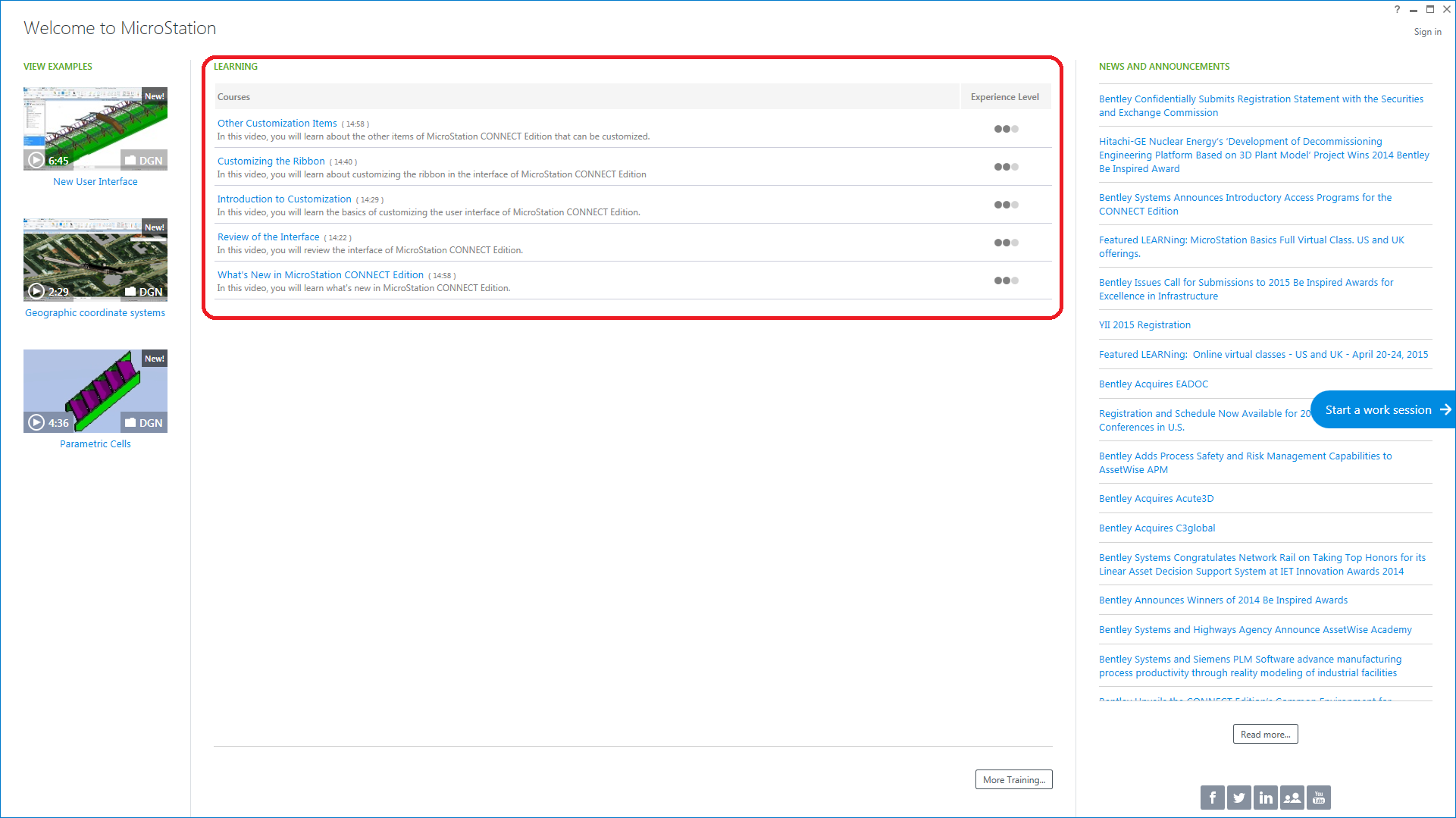

When viewing the Welcome Page, there are only 5 videos/links listed in the LEARNING section, why is this? See Image 1...
 Image 1 - Minimum LEARN content..

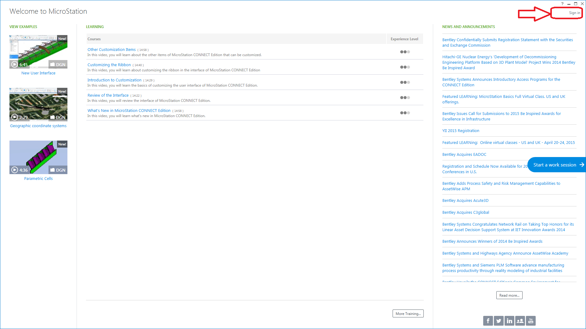

  1. To see more LEARN content links listed, you must be signed into the CONNECTION client
  2. Click on Sign in in the top right hand corner of Welcome Page (see Image 2)
  3. Sign in with credentials

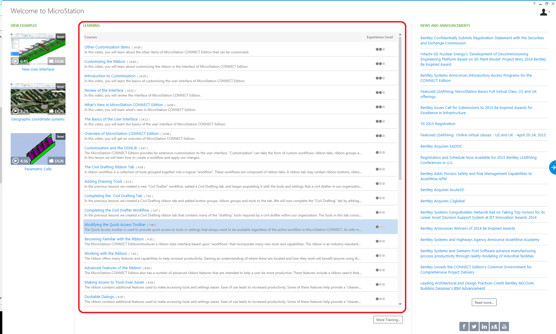

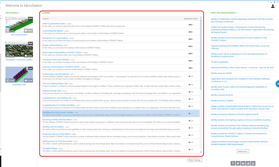

  4. The Welcome Page should now list more LEARN content (see Image 3)
Note: The level of SELECT coverage may reflect what content is displayed
Image 2 - Sign in
Image 3 - Full list of LEARN content
